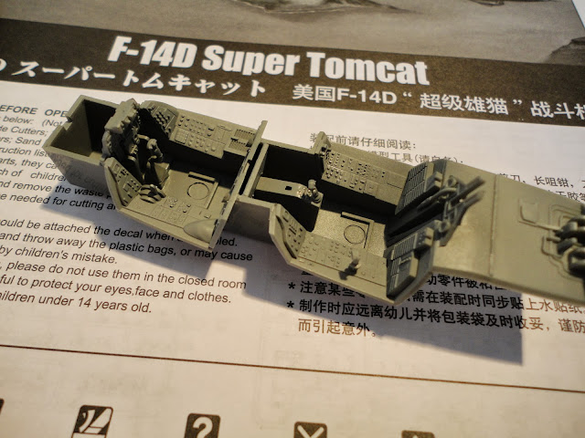

Firstly, the cockpit; you would only be able to beat this cockpit with a resin cockpit, and even then some of the resin pits are not as up to date in terms of MFD's and the RIO's sidecontroller.

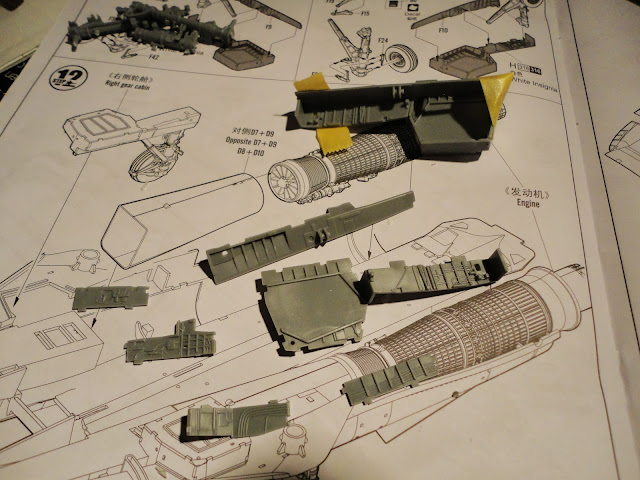

Secondly, the main gear bays; these fit together extremely well and don't clash with the intakes. The undercarriage installation calls for the gear legs to be inserted during the bay construction, but this isn't necessary.

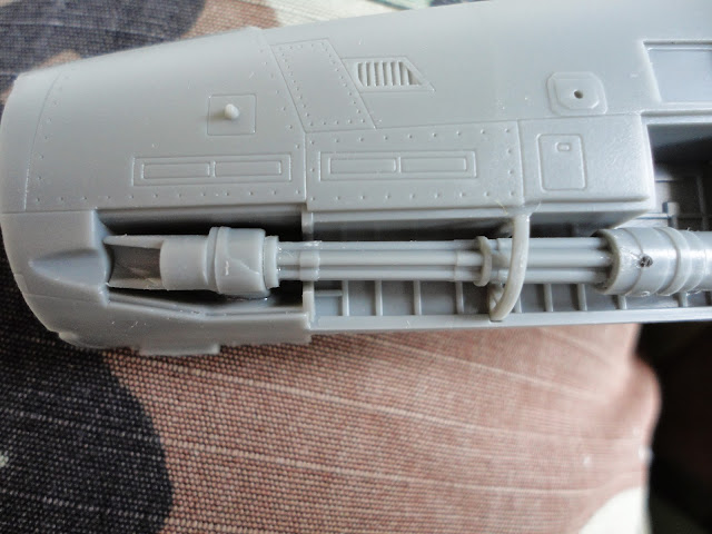

Thirdly, the details; this is the first kit I've seen with such a detailed Vulcan, most especially the detail in the cannon port, outstanding. The weapons load is superb and varied (bizarrely including AGM-88 HARM and AGM-84 Harpoon?!) and , yet unfortunately the kit only provides two ADU-703 and BRU-32 bombracks. Minor, but annoying.

The impressive Vulcan assembly (it's being dry fitted here, so it's not lying correctly)
The cannon muzzle

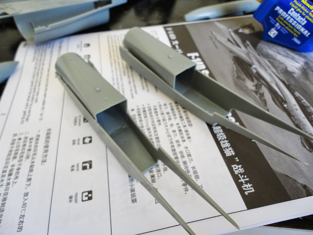

Intake trunks mount as another major manufacturers do
The awesome cockpit primed and ready for detail painting
The main gear bays. Easy to assemble and very robust.
Fits like a glove!

Dry fitting the painted up pit

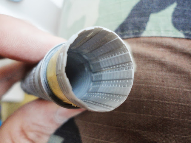

The exhaust petals are provided as a separate assembly, which assembles around a ring. Sounds very complex, but surprisingly it is easy and has a very positive fit.
Hobby Boss have also provided the exhaust internal ceramic plates. This attaches to the end of the exhuast tunnel and the option is provided for either 'open' or 'closed' petals with corresponding plates. Once again, this level of detail is usually only seen in resin A/M sets.

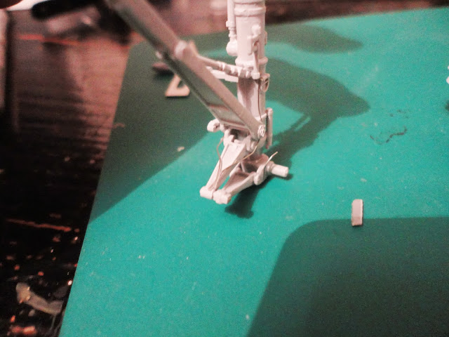

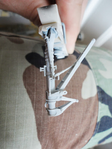

The main gear is next-level detail. Comprising of 9 pieces per gear leg, it is begging to be 'jazzed up' with brake cables etc. Honestly, this level of detail isn't even available in A/M sets! Oh, and make you sure you have a copy of Mr Danny Coremans' finest work as reference as the instructions are a bit vague. I would not have been able to construct these without Mr Coremans' and Mr Drendel's works!

The intake trunking has been sanded to death, but as ever, the camera never lies! Frustratingly you can see the seam, so I'll wait till the paint is dry and sand it down again... ](*,)

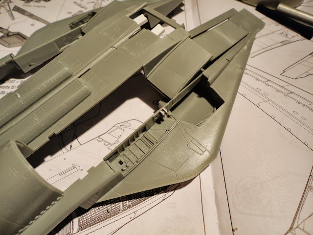

More progress today. I tackled the wing assemblies which are another load of great detail, but do require a bit of work to build swung to the rear. The wing has better detail for the flaps and slats and some really positive locating nubs than another vaunted F-14 kit. This really makes it easy to display the wings with everything 'hanging out' in the forward position. This will be a boon if you are contemplating a launch dio or similar.
On to the wings; these come in 6 pieces. The slat, the wing upper and lower, the 'bottom' of the flap and the flap halves. Note also the solid ring for the wing pivot, more on this later.
The F-14 flap is a complex affair; I'm not sure how best to describe it, but it swings to the rear and down, it doesn't just pivot on a central axis. To allow the air flow to continue, what I call the bottom of the flap hinges up. Hobby Boss have this part represented, which needs to be glued in flush with the wing surface to avoid a gap between the wing and the flap. I you were displaying the wing with flaps deployed, this would be angled to allow the airflow to flow under the wing and over the top of the flap.
The underneath (not yet glued) to show the area filled by this flap part.
And with the flap in position
The wing pivot is a complete circle, which would necessitate attaching the wing during construction, which can be a pain. So, a quick snip and just over 2/3 of the circle remains, allowing one to slide it into the model after painting.

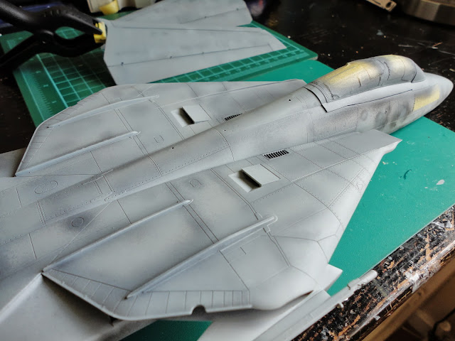

Some progress made here, I have pre-shaded the plane and in consultation with the resident Tomcat SME (that's you DaveJL ) have concluded that the VF-31 F-14D's were a dirty bunch of weathered birds. I'm going to make an effort to make this really grimy and weathered. (Actually makes it easy to hide my poor airbrush skills as a bit 'thin' here, 'too thick' there is just what this needs! [:banghead:] )

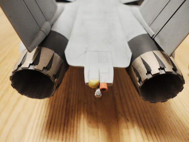

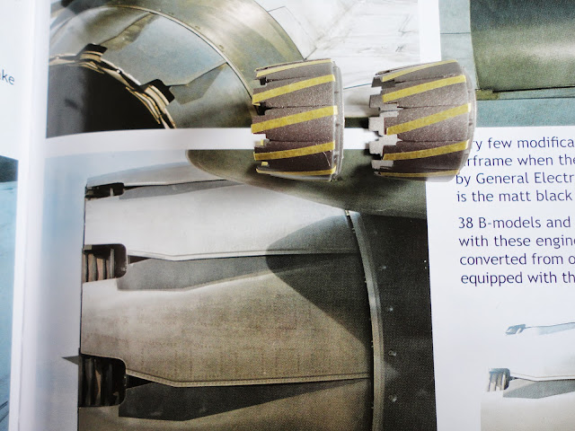

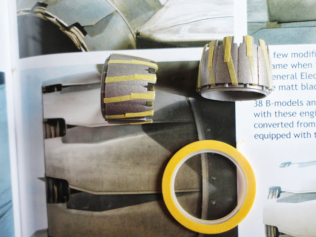

Today's fun was masking the GE petals. I decided to mask rather than use decals or try and paint the demarcation overlap on by hand. Bonkers, but the results are really worth it. On the ground, the GE petals are typically splayed (though there are a few pics of them closed on the ground) and reveal the demarcation of the outer petal and the darkened edge of overlap. Lost you yet? Pictures paint a thousand words...
Using the DACO book for reference, I started out with some 1.5mm AIZU tape...
Then...
All done...
A quick spray of black...
And the reveal! It was worth it (masking took about 45min) and though there are one or two areas that need a touch up, it's minor.

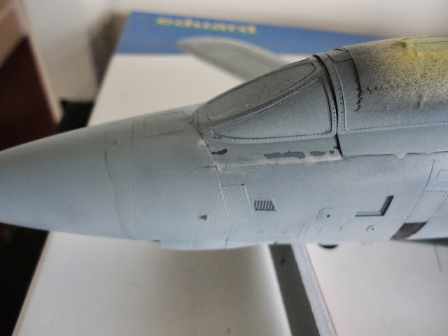

Cheers Josh. Annoyingly, a seam that was sound has now revealed itself under the first coat of paint - it didn't under primer, but there it is, proud down the wing gloves. So, off to fill and sand...

Getting some paint down finally. The Eduard canopy masks are great, saves so much time!
I'm going for quite a weathered look, and, not being bold enough to go for the hairspray technique, am going using the chromatic effects technique. I'll be spotting and overlaying, cutting with white, splodging and mottling.

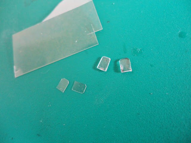

Having an off-ish morning, I managed to disfigure the HUD screens, so it was out with the acetate.
Annoyingly there was a small gap in the join of the cockpit windscreen, so my old buddy Squadron White got to get in on the action.

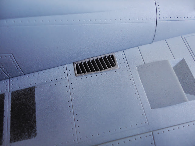

Decided to mask and paint the roughened walkway area on the top of the intake. This area gets quite worn, so the solid decal most kits and A/M decal sheets provide are not actually that useful when portraying a grimy line jet. Masked off and sprayed some lightly thinned matt black to get a stippled effect.
Et voila!
Also masked and sprayed the gun muzzle, intake dorsal vents and swing wing 'bags'

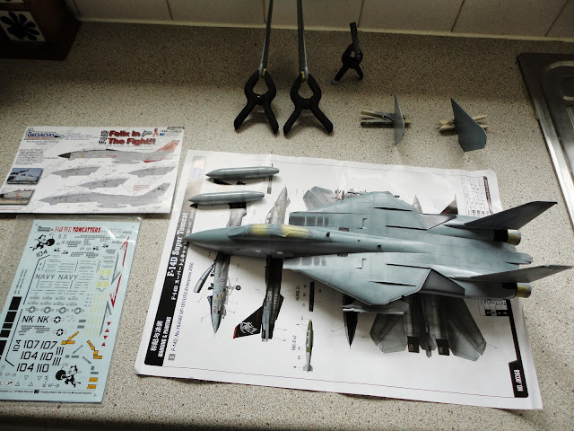

Time for some decals!
Age : 38
Re: Hobby Boss 1/48 F-14D VF-31 'Tomcatters' (80368)
Post  Parabat on Mon Aug 26 2013, 20:37
Nearly there now...
Remember the lead shot and PVA nose weight earlier in the build? I stupidly didn't put in the radar backing plat/bulkhead, so when I was wet and dry sanding the forward fuselage and washing the swarf off, the PVA ran into the cockpit and into the windscreen.  Evil or Very Mad Luckily, with a bit of coaxing with a cut down damp toothpick, you can barely see the evidence of it having been there. Almost a good thing I hadn't installed the HUD!
So, lesson being, if you're going to use PVA to secure the nose weight, make sure you install the bulkhead between the nose and the cockpit!

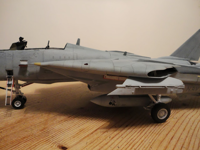

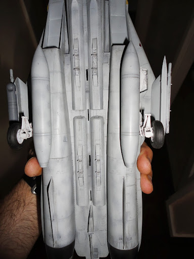

Anyway, here's we we stand tonight. Decals on, matt coated, wheels on. Just the undercarriage doors, weapons, ejection seats, wings, HUD and canopy to go, with some varuous bits to pick out in little bits of colour.

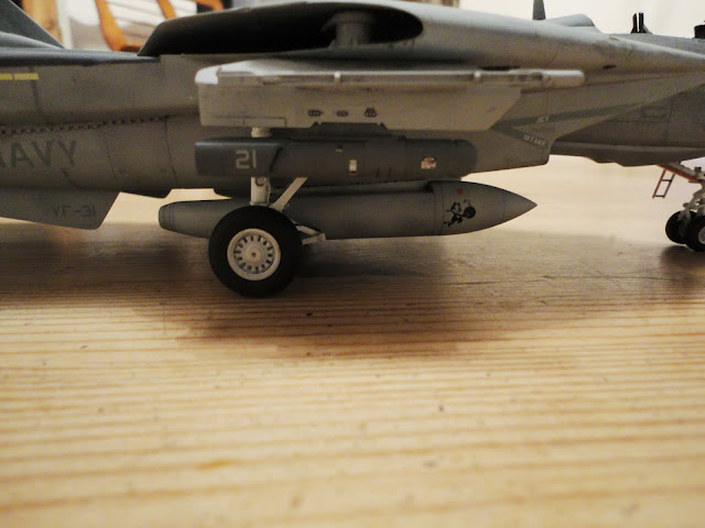

I shortened (horizontal breadth) and thickened the steps to better match the real steps.
The arrestor hook needs shortening by about 2-3mm to bring it into the correct length. The best place to cut is just after the round 'bumper' on the dorsal side of the hook rod.
The fuel tanks are mounted too far forward, by about 4-5mm. This is really noticeable as the tanks then stick out ahead of the intake lip. Make sure you bring the mounting holes rearwards early on in the build (not like this callsign  Rolling Eyes   )
The LTS (LANTIRN pod) is the kits own and the decals are also from the kit. I used some artistic license and cut the '21' from the VF-213 kit ventral strake decals to better mnatch the VF-31 LTS pod markings over the kits silver '17'.
And the grimy underneath... Frutratingly, Hobby Boss only provide sufficient sway braces to equip two BRU's (Bomb Release Units), though they provide four BRU's... Evil or Very Mad   Still, if you model a late bombcat (2005/06), most of the time they only used the front two pallets and flew with the rear clear.
